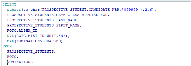

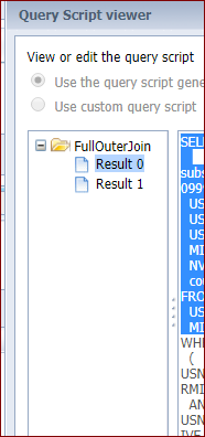

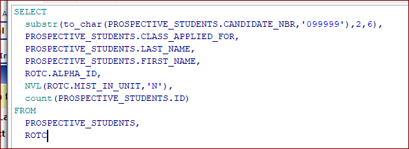

I have a pretty simple query, or so it seems, but WebI is doing the Full Outer Join with two queries, I don’t understand why, 1st screen shot.
Shown are the two queries - - - all the joins are there and such, but one is doing count(prospective_students.id) and the other does max(nominations). So not sure why it’s doing the two queries.
If I get rid of the Max(nominations.charged), and add in nominations.charged, it’s just one query. If I get rid of the count(prospective_students.id) and keep max(nominations.charged), again it’s one query.

When I do the combination of
  • MAX(NOMINATIONS.CHARGED) and
  • COUNT(DISTINCT PROSPECTIVE_STUDENTS.STUD_ID)
then it does two queries, and the first COUNT query ignores the necessary join to get MAX(NOMINATIONS.CHARGED).
then if I don’t do MAX, I get one query using
  • NOMINATIONS.CHARGED and
and it DOES the necessary join to get NOMINATIONS.CHARGED.
So the only difference is MAX(NOMINATIONS.CHARGED).
The screen shots in my original post show the results.
If I take the WebI query with MAX(NOMINATIONS_CHARGED), go to Oracle SQL, and then add COUNT(DISTINCT PROSPECTIVE_STUDENTS.STUD_ID), the query works fine.

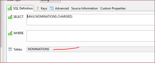

One tiny thing I noticed - in Universe Designer, MAX(NOMINATIONS.CHARGED) shows the associated table, whereas another object of simply NOMINATIONS_CHARGED does not.
And I’m stumped … I’m not asking for troubleshooting per se, but what is WebI thinking? oracle handles it fine but WebI for some reason is doing it with two queries.

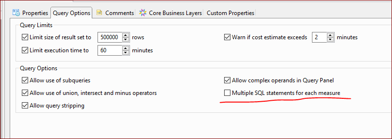

There is one universe parameter (don’t remember its name) that, when used, causes that WebI generates one SQL statement for each measure. Check whether it’s used in your universe.
:shock: :shock: :shock: :shock:
Do you have more than one table from which you’re getting measures? If so, start planning for adding contexts.
Yes, that did the trick!
In the Universe parameters, I unchecked “Multiple SQL statements for each measure”, and now I’m good-to-go …

Although our team decided to keep it checked as “Multiple SQL Statements for each measure.” So we have the two SQL statements, but it provides the expected results and performance is ok / fine.
Technically, it’s “Multiple SQL statements for each AGGREGATE”. One is a measure and one is a MAX(dimension).
