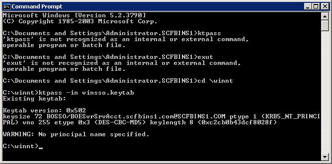

Thanks for the reply. We ran a check against our keytab file using the ktpass command. I have attached the results in the attached .jpg file. I hope you can open.
It appears to have returned the desired results; however, it gave a warning:
“No Principal name Specified”
Not sure what this means unless it should have been specified in the command line.
farmcock (BOB member since 2008-01-15)
This key seems fine, the warning msg is ok to ignore.
My concern is that the key was created with the SPN “BOSSO/…” when it should have been created with the SPN “HTTP/…”
It is the latter that works with HTTP traffic for SSO.
In the end, you should have two SPNs defined: one arbitrary type “BOSSO/…” for delegating the logons to AD, the other service type “HTTP/…” for web traffic to use SSO.
lgonzalez (BOB member since 2002-07-17)
