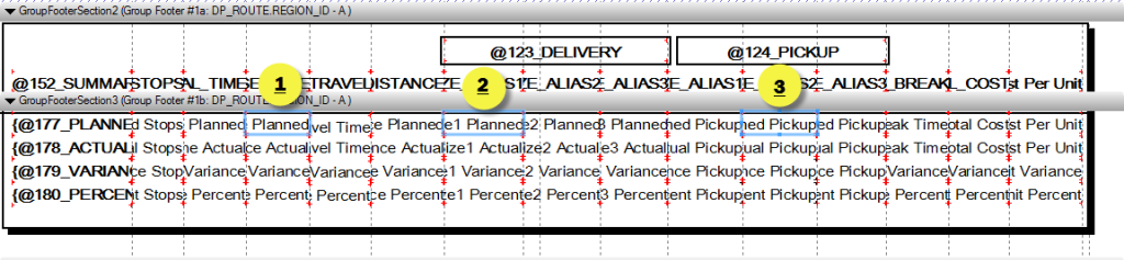

Please forgive me if my terminology is not up to Crystal Report standards.
Given a group footer, when you have multiple sum boxes. One box gives you the sum of X and another box gives you Y. Can you create a third box and put in the formula box X / box Y ?
Please see attachement
Box 1
@Planned Total Service Time (String)
whileprintingrecords;
NumberVar SPlannedService;
upsltRunningTime (SPlannedService,false )
Box 2
@Total Size1 Planned Pickup (Number)
NumberVar PlannedStopPickup1;
NumberVar PlannedOrderPickup1;
NumberVar Size1P;
NumberVar SummarySize1P;
if {?UPSLT_CMN_MC_LEVEL_DETAIL}=“0” then
Size1P := PlannedStopPickup1
else if {?UPSLT_CMN_MC_LEVEL_DETAIL}=“1” then
Size1P := PlannedOrderPickup1
else if {?UPSLT_CMN_MC_LEVEL_DETAIL}=“2” then
Size1P := {#Lineitem Total Pickup Planned Size1};
SummarySize1P := SummarySize1P + Size1P;
Size1P
Custom Box 3:
@Total Size1 Planned Pickup / @Total Size1 Planned Pickup
There would be conversion problem, but would this logic work?

The formula you were using for Box 3 would have given you the result for just the last row in the group. You will need to use:
Sum( @Total Size1 Planned Pickup,{insert your group column here} ) / Sum( @Total Size1 Planned Pickup,{insert your group column here} )
This will sum Box 1 (for the current group) then divide it by the sum of Box 2.
For best results you should be converting Box 1 to a number first (you can do this either in your original Box 1 formula or in the Box 3 formula - use CDbl or ToNumber to do the conversion).
Hope that helps!
Cheers
Daniel
what’stheplandan :australia: (BOB member since 2016-03-07)
Looking at what you typed, your division would always return a 1: @Total Size1 Planned Pickup / @Total Size1 Planned Pickup. But I assume that’s not what you want. :slight_smile:
Just a note about doing division of sums or counts - you always need to check the divisor to make sure it’s not zero before you do the division, otherwise Crystal will error out if that happens. So, I would rewrite Dan’s response as this:
If Sum(Box2,{insert your group column here} ) > 0 then
Sum(Box1,{insert your group column here} ) / Sum(Box2,{insert your group column here} )
else
0
-Dell
Box 1
-CODE-
//will this work for converting?
TONUMBER({@Plannted Total Service})
does the logic in sequence from top down ?
