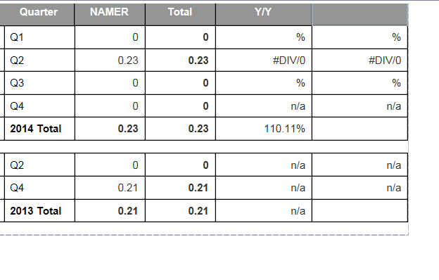

Iam getting #div/0 error in my webi report
I attached File , you can see it .
How to solve this issue.
Thanks…

You can “error-trap” your calculation with the iserror function:
=if iserror([Your Calculation]) then [something else] else [Your Calculation]
HTH
NMG

are you using number/total or number/year. If anything you can avoid that error by applying the condition div/0=1 else 0
