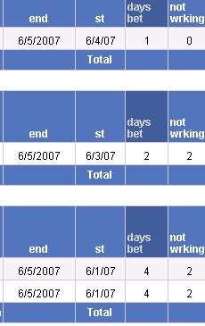

When i try to use this for dates 6/3/2007 and 6/5/2007 it gives me 0 days.
Please find the screen shot.
For 2nd and 3rd calculation the not working days is 2.
But for the second one it should be only one.
??.Am i missing something.
–H

Check your date format whether it is mm-dd-yyyy or dd-mm-yyyy then check your no of days formula…

Its in mm dd yyyy.And if we calculate using the formuale the results do not work out.
Thanks,–h
