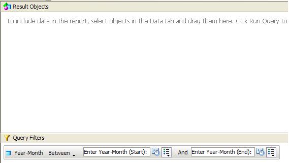

Please see the attached. Bring the PRS Month to the Query Filter and use the between operator and Prompts. I hope the PRS month is an universe object. Hope this helps!

Hi John,
thanks for the response. This is what I originally did but the user is not happy. He wants it more like a drop down filter. A DD filter for Start Date and another for end date in the report.
