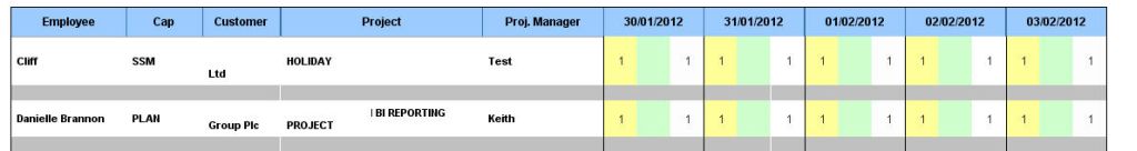

Here are the first couple of rows. It is a crosstable, the column headers are formatted in an extended row of their own.
I’ve tried creating a new report in both horizontal and vertical axes and both simply depopulate when a ToDate function is used.
As I say, our data is coming from BPC10, which does not have any kind of 0calday object (or similar) - each type of date is listed as master data in the same attribute (ie. day, week, month, quarter etc.) and brought through as a character string. Is this what could be causing the problem? In WebI, only days in the format dd/MM/yyyy are shown, but in the back end there are all sorts of different date formats for different time periods.

Can you give some examples of these?
Are you sure that there is no padding on either end of the returned string? You can test this by using the length() function?
