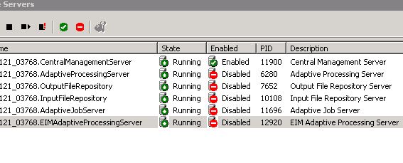

I am getting the same error as discussed in the topic.But this is while trying to open the management Console, The error is as shown below.
Unable to find servers in CMS DBServer.mycompany:6400 and cluster @DBServer.mycompany:6400 with kind pjs and service DS.AdminService. All such servers could be down or disabled by the administrator. (FWM 01014)
As seen in the attachment, CMS and EIM APS Servers are running. What do need to check on to resolve this.?
rajnia1 (BOB member since 2011-11-17)
this is different error that password retrieval access permission
check if the DS.AdminService is hosted on the EIM APS, for this go to CMC, open the properties of the EIM APS and check for the services that are on this Server
If you see DS Admin Service, then go to the BOE/IPS HOME\SAP BusinessObjects Enterprise XI 4.0\logging folder and check for errors in DS.AdminService.log file and also in the EIM.glf file
