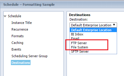

I need to remove the dropdown list(FTP Server and FTP System) from report destinations while scheduling the report. I made changes in the webireportdestination.jsp file. But it is not reflecting in the even after deploying the war and restarting the tomcat.
  1. Can we edit and make changes in jsp files in 4.2 ?
    2.How to remove the destinations (FTP Server and FTP System) from dropdown ?

For anyone searching this thread and still wondering if it’s possible, you can do it in 4.2
  1. you need to edit the war file, replacing the original jsp file with your changed version
  2. redeploy the war file to get the change to stick
Obviously your change will get wiped out each time you patch. (I’ve built a command file to automate the process for the files I need to modify)
