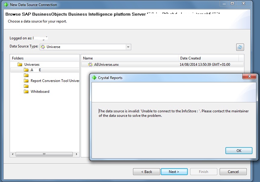

I am using BOXI 4.1 and have just installed Crystal Reports for Enterprise. However when I try to create a report connecting to a universe I receive the following error:
The data source is invalid: 'Unable to connect to the InfoStore : '. Please contact the maintainer of the data source to solve the problem.
Any ideas?

Attached is the message i’m receiving.
esinclair :uk: (BOB member since 2006-09-12)

I do not know what was in the the link. But two things always gets in the way when using universes for us. The user must have at least ‘View on Demand’ rights for the connection and the universe.
kevlray :us: (BOB member since 2010-06-23)
Thank you for the response kevlray.
I was getting error when login as an administrator into CRE designer.
The issue is resolved now as I have restarted 32bit and 64bit connection server which resolves the issue.
