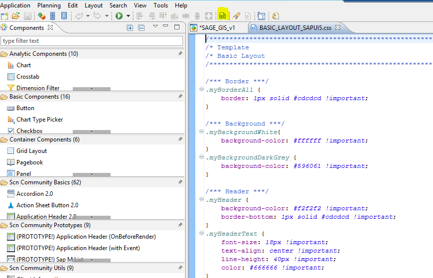

try to add that code to the CSS general properties file, find attached an screenshot with the marked button.
I also attached a complete list of css properties for the crosstabs, it’s an older version but I found it helpful.
