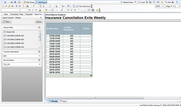

i have created a caller exit by inputs report and added in ‘session hour’ to get an hourly view of data. i would ideally like 15 min intervals if anyone knows if thats possible and what to add to my query.

ive set the report up and I can get the data per hour of day, but I’d like it per 15 min interval if you know what i need to add to my query please?

sorry my knowledge is limited. the screen shot is what i currently have. i added ‘session hour’ to my query then added the column from that. that gave me ‘exits per hour’ on the table.
i had assumed (and we all know what assumed did!) that there would be a ‘per 15 mins’ data identifier i could add to my query, but i just cant find one.
do you know of one or is it simply not that easy?
