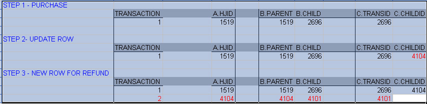

The end result looks like this
Initial transaction 1 (purchase)
(see step 1 in attached file)
Next refund is processed - so C.childid gets updated with 4104 in the row for transaction 1
(see step 2 in attached file)
and the refund transaction is now entered into C as c.transid = 4101
and there are 2 rows in C now for the 1 customer.
(see step 3 in attached file)
I don’t know how to represent this in a universe though?!!
I need to be able to bring back both rows in a report!
Any help would be very kindly appreciated! ( I hope I’m making sense!)
HOW TO JOIN.xls (18.0 KB)

Hello.
What about building a view with your SQL and using the view in the universe?
lgonzalez (BOB member since 2002-07-17)
How about a complete separation of refunds from purchases? To do so you will need to alias C table --> C_purchases will contain only purchases and C_refunds will have only refunds. Then both tables will be joined to all tables where it’s needed and there will be 2 context - 1 for purchases and 1 for refunds.
I’ve been working hard at this (and another problem) to get it working with SQL and tested- in the end I made a view doing a union of 1 query to show me all purchases and 1 query to show me all refunds- and then used this view in my main query
However I’ve ended up with an ‘or’ join in my SQL and I don’t know how to represent this in the universe!!!

Seconded. Self-restricting joins on the two tables - they serve two different purposes and you can report on the refund and purchase dates for the same transaction then by aliasing the date table accordingly.
I did try that way but I couldnt get the rows to display underneath each other for each customer - however I’ve never used contexts and so I was trying to do it via SQL :oops:
im sorry to ask but could you give me an idea if this is correct
enter alias table C- so now there is C_purch and C_refund
I don’t understand how I can join them though as where there is a refund - the only way to link it back to a customer is by looking at the purchase accountid
so for purchases I would join
C_purch .TRANSACTIONID = B.CHILD_TRANSACTION__ID
and B.PARENT_TRANSACTIONS_ID = A.HJID
and for refunds I would join
C_purch.CHILDTRANSACTIONS_TRANSACTIO_0 = A.hjid
and B.CHILD_TRANSACTION__ID = C_refund.TRANSACTIONID
and then create a context for each to show which is a purchase and which is a refund?
I’ve tried that in CR XI it wouldnt let me add in the transactionid from both c_purch and c_refund saying ‘Query generated multiple SQL statements, however multiple SQL is not supported in Crystal Reports Query Panel’
I don’t understand how contexts will work as I couldnt even make this work in SQL- there are other tables linking into A which give the accountid etc and they join to only the purchase transaction…
in my example attached they will only join to the transaction 2696- i can’t see how to make an accountid to join to 4101 also!

Thanks- I tried out both suggestions- I don’t understand how to do contexts at all so I went for a view in the end with all the joins I needed!
