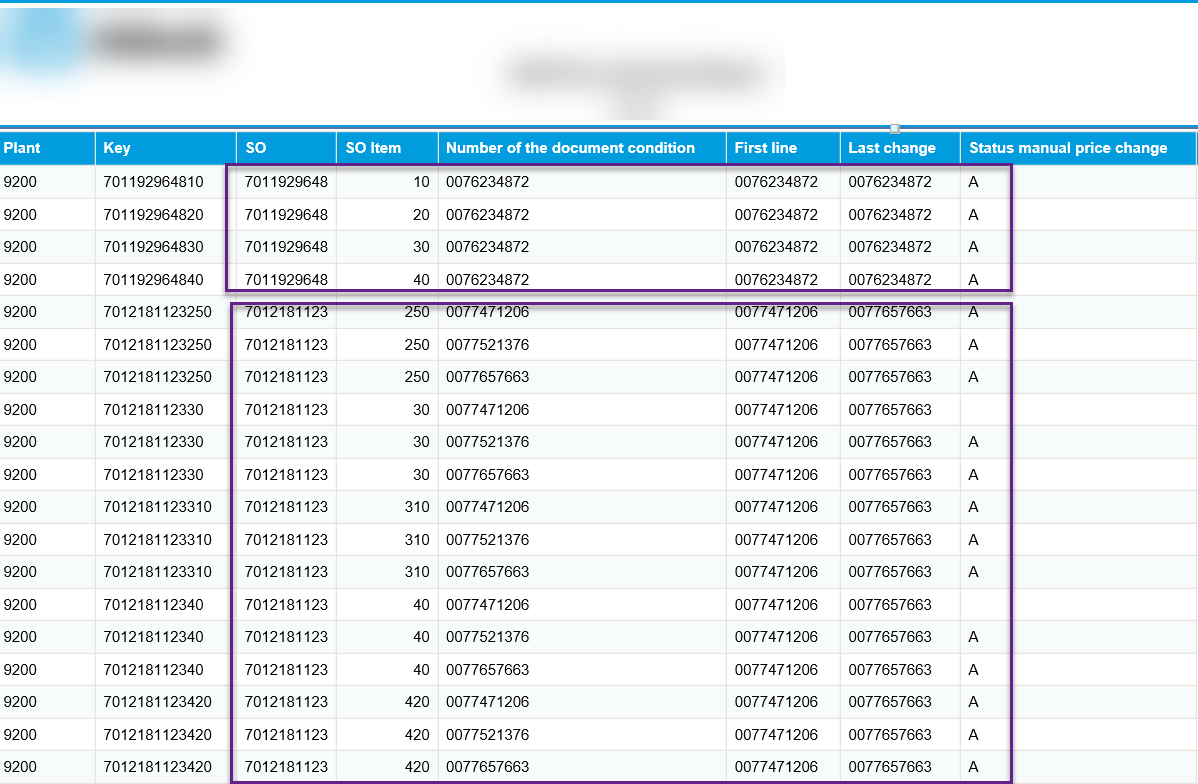

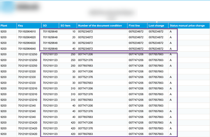

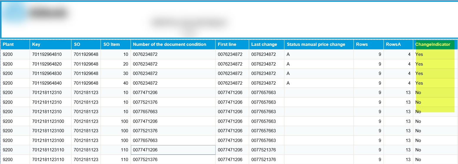

This is the issue :
There are 2 SO’s in this example. You see for the first SO all lines have an “A” in Status field.
The second SO has two lines without an “A”.
What I now want is 1 field that counts all lines in an SO and a second field that count all lines with an “A” in an SO.
Somehow all my counts just return not the correct numbers in both cases.
What would be the correct way to count this table?

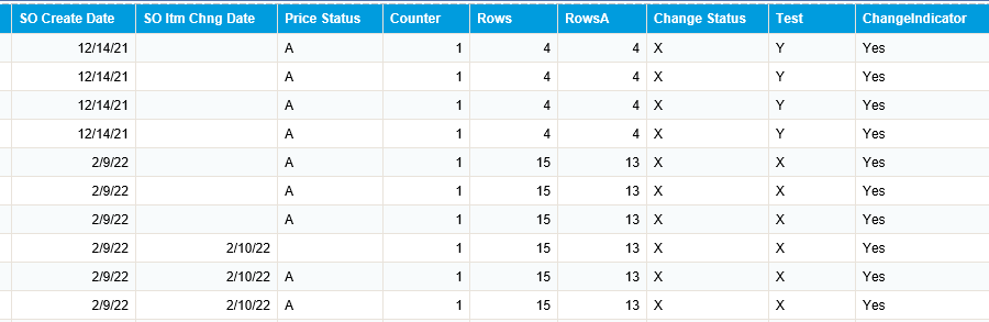

I have a change indicator in the report that was set to Yes.
It will always be at yes anyway but I want it also to work when Yes and No are visible but it doesn’t:
Was trying with this:
=Count([ChangeIndicator];All) In ([SO]) Where ([ChangeIndicator] = “Yes”)
But where it should count 15 it only counts 9…

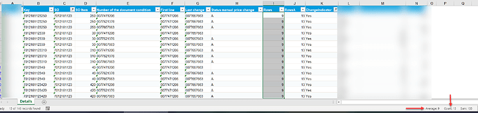

Brought it into excel and found :
Excel counts 15 and says the Average is 9…I get 9 in Webi…don’t think that is a coincidence?
Why would the count formula give me the average?

What are your formulas for Rows, RowsA, and ChangeIndicator?
Ok I will list the formulas I already have (where ChangeIndicator and RowsA already work fine)
ChangeIndicator:
=If Not (IsNull(Count([Status manual price change];All) In ([Key]) Where ([Status manual price change] = “A”))) Then “Yes” Else “No”
RowsA:
=Count([Status manual price change];All) Where ([Status manual price change] = “A”) In ([SO])
Rows:
Ps: No I want no line under each SO to summarize.
Also RowA (the count of A’s) is working.
Its Rows…which I would think would be the most standard of the three :slight_smile:
*Edit: listing them I saw RowA and Row are slightly different (where they actually should do the same) in where i place the IN and WHERE clause.
However changing Rows to:
=Count([ChangeIndicator];All) Where ([ChangeIndicator] = “Yes”) In ([SO])
Did not change a thing unfortunately

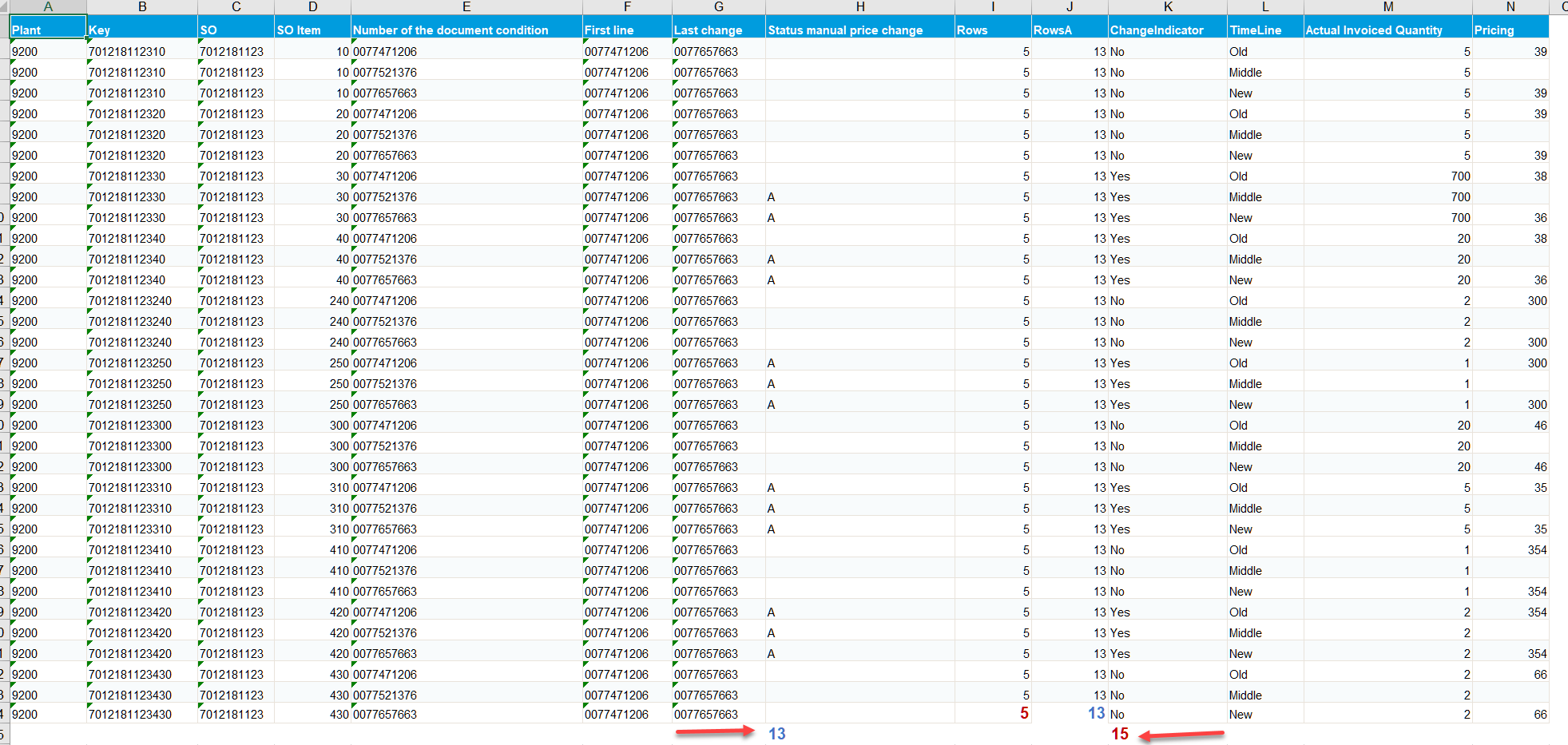

Ok let met try to explain with this Excel screen:
So this is for 1 SO. This SO has a lot of SO items but only 5 items have been changed, indicated by an “A” (SO item 30, 40, 250, 310 and 420). The changes are indicated by number of document condition.
Now I made change indicator to identify these 5 SO items that are in scope. At the end I will filter this report to show only with changeindicator “Yes” because the rest is out of scope.
As you see SO item 30 has 3 lines and only 2 “A’s”.
I made changeindicator in such a way that also a “Yes” comes in on the line within SO item 30 that has no “A” so that is good (all lines from SO item need to get in if there was somewhere a change in the SO item)
The “yes”/“no” works just fine.
Now you see that when you count all “yes” there are 15.
When you count all “A” there are 13 (you see SO item 30 and 40 both have a line without “A”)
These numbers are correct.
Now when I count all “A” in RowsA field it gives 13, so that is correct.
However when I count all rows with a “Yes” in field Rows I get 5…
It should give 15 because as you can see there are 15 “Yes” in the SO.
5 is the number of SO Items with an “A”, but the formula is counting lines with “Yes”…is it not??

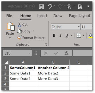

Take this simple spreadsheet for example…

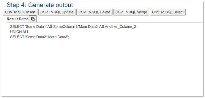

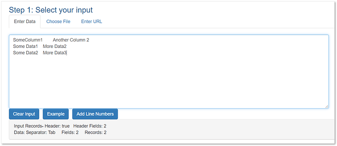

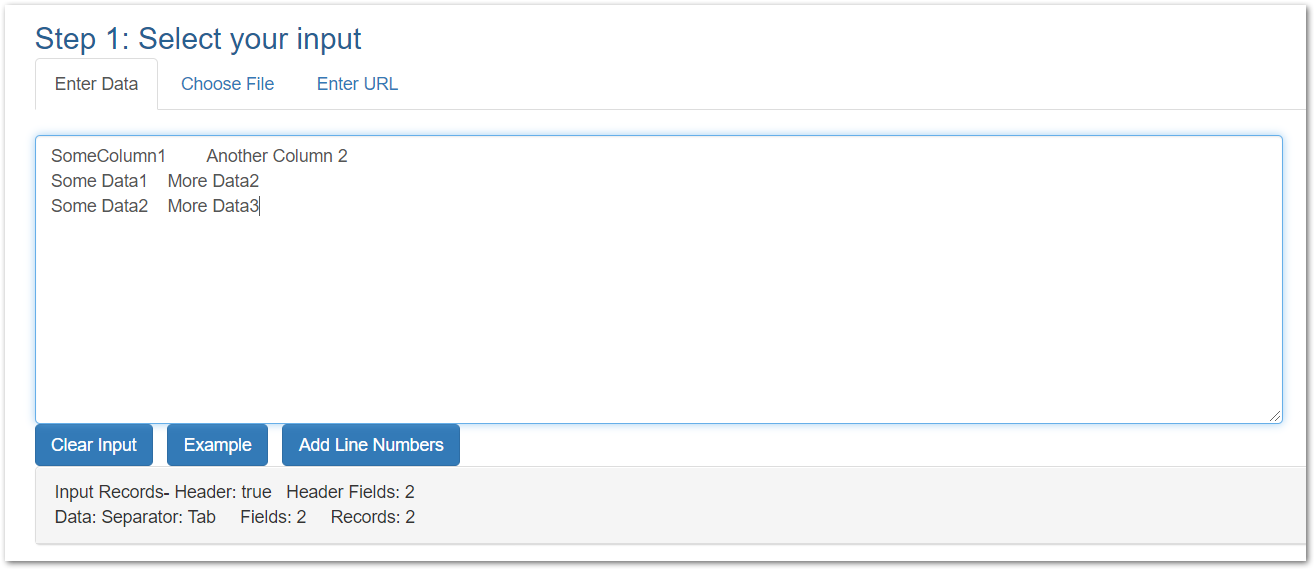

I can copy the sample data from my spreadsheet and drop it in this website
There are a bunch of options here. All you need to do is…
  1. Find “Create Table/View” Step 3 and uncheck it.

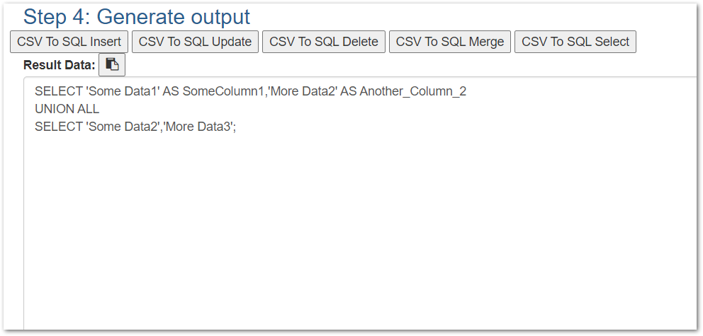

  2. In Step 4, click the “CSV To SQL Select” button.
Now you have some SQL that you can use as free-hand SQL. Even better, you can share it here so that we can be working with the same data you are. Ideally, you would build out your example with this free-hand SQL query.
You could even go a step further and drop that SQL into dbfiddle and verify it actually runs and is accurately reflecting your situation and share that link.
We can then take that SQL drop it in our own free-hand SQL query and if you provide us the formulas for any variables we theoretically now have a report the exhibits the issue you are having.

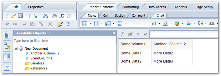

I fully realize that I am not answering your question. I am trying to help you help me so that I can help you. Short of data to work with there isn’t much I can do.
Ok let me try this.
I think I did everything like you said but when I paste this SQL in dbfiddle it gives an error…
So I will paste the SQL here hoping you can still look at it or tell which step I did not get right.

In the mean time I gave it another shot with a workaround.
So where I first counted all lines in an SO where the ChangeIndicator was “Yes” I now made a counter.
1 if ChangeIndicator is “Yes” and 0 if it is “No”.
Surprisingly the sum of this did give me the correct amounts per SO:
The first 4 lines are a different SO and you see they all have an A. Both row counts now show 4.
And the other SO has the 15 I was looking for.
So with the workaround this works, but of course counting the “Yes” for each SO should also give me the 15.
Now…immediately ran into the next strange behaviour in my data set…
Field Change status compares the 2 Row fields. If they are equal it should show Y and else X.
A simple if (rows = rowsa) then will not work…
Apparently this way 4 <> 4 ?? (If say rows > rowsa then it does work…so somehow the first 4 is more than the second 4…)
Also this I could tackle with a workaround by using if (rows - rowsa = 0) then Y else X (field Test)
That does work but I do not get why direct comparing the outcome of rows and rowsa does not work…
Lets hope you can get my data set sql to work.
Nice work! I think it didn’t like your use of Key as a column since that is a SQL keyword. To resolve that I enclosed it in square brackets…
701218112310 AS [Key]
Also, the your quotes were curly (‘) rather than straight ('). Picky, I know. Anyway, now we have a some working SQL to work with.

Bottomline:
A SO has SO Items. When something changes in such an Item it will get an A (and new doc condition number)
First thing I did was isolate the combi SO+SOItem (old field Key which I changed to Combi because of SQL)
Field ‘ChangeIndicator’ now gives yes if an SOItem has an A somewhere in one of its lines.
Example: combi 701218112330 has 3 lines and 2 have an “A” so all 3 lines have ChangeIndicator “Yes”.
Next step is the one I have problems with.
Because you will have 2 situations.
A) All the lines with “Yes” changeindicator for a combi have and “A”
B) Lines with “Yes” have also blank lines so there are less lines with an “A” then total lines in a combi
In the example I named those “Status A” and “Status B”
So these two states I want to identify for the lines with “Yes” in changeindicator.
To keep it all a bit readable I will paste the SQL in a next post.
