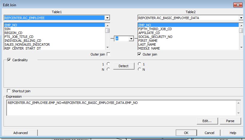

When I create a join with a single field I select the outer join. When I add the second field (for the complex join) it appears to switch which table my outer join is actually applied to!
When I look at the SQL that is generated it puts the outer on the opposite table that I selected it to be on.

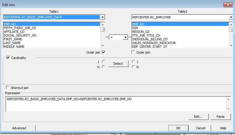

I have noticed this happens sometimes too. I just manually change it in the expression box. I save it and reopen to make sure the changes really saved.

I feel like I’m losing my everlovin’ marbles! This join will NOT do what I tell it to do…
I want an outer join on
RC_BASIC_EMPLOYEE_DATA.EMP_NO=RC_EMPLOYEE.EMP_NO
Everytime I create it and export the universe I go in to the report and look at the sql generated and I get
LEFT OUTER JOIN REPCENTER.RC_EMPLOYEE ON (REPCENTER.RC_EMPLOYEE.EMP_NO=REPCENTER.RC_BASIC_EMPLOYEE_DATA.EMP_NO)

I have another universe with the exact opposite join in the universe that generates the same SQL. I have different reports. One the outer join needs to be on EMPLOYEE and the other requirements if for the outer join needs to be on .RC_BASIC_EMPLOYEE_DATA

At the bottom you will see the box on the right that says “Edit”. You can change them there. I’ve found that if I have a complex join it seems to work better to create two separate joins.
