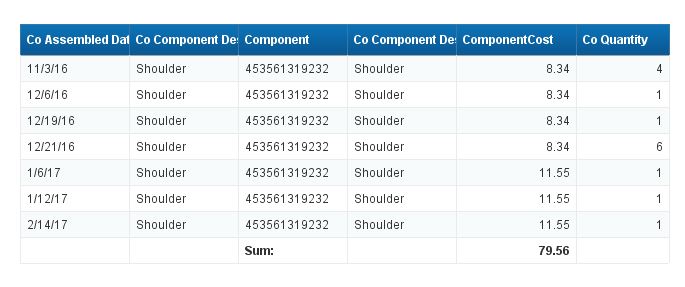

When I have a data set like this, see screenshot 1.
I can merge this on the report. See screenshot 2.

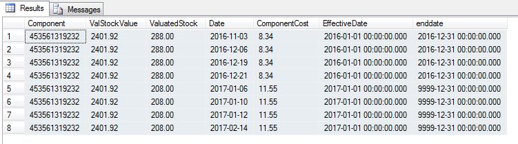

For the final result I would like to achieve see screenshot 3. But because my data is shown in two months I get this multivalue issue.
I connected my two queries on these fields:
in the query panel I used the combine use the result from another query.
  • co assembled Date equal to Date
  • Component equal to co component
Is there a way to combine the rows in BO or in the universe? I am using the UNX universe. I don’t have permission to use the IDT universe.

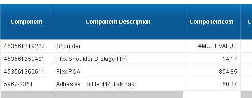

But what I get now when I remove the date field in the report for a roll up I get a Multivalue error.
Is there a way to show the correct value in the table?
