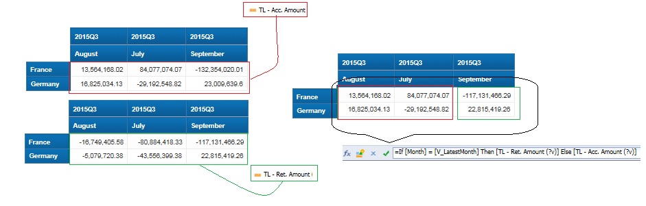

This is possible in a single cross tab. You just need to capture the latest month in a variable(V_LatestMonth) and then use that variable to display data accordingly. I have taken an example. I have a cross tab in which I am having “Location” & “Months” as Row & Column respectively. I also have two different measures “Acc. Amount” and “Ret. Amount”. I will display Acc. Amount for all the months except the last month. For last month I’ll display Ret. amount.
The variable definition of V_LatestMonth=Month(ToDate((Max([Month]) IN REPORT);“MM”))
Now please follow the snapshot attached. The first table in snapshot displays Acc. amount and second displays Ret. amount. The third table output is what you are looking for. In third table all the months have Acc. amount except the latest month (has Ret. amount).
Please let me know if this helped you.

Thanks for the help.
I’m sure your solution should work, only thing is that at first step I am having issues to get the max Month.
basically my data is from BW, so 0CALMONTH (cal.year/month) , when I try the following formula it is failing:
=FormatDate(ToDate((Max([Cal. year / month].[Cal. year / month - Key]) In Report);"MM-yyyy");"Mmm-yyyy")
Any solution to this. It has taken an awful lot of time for me to get the max month of this [Cal.year/month] … data is 02/2016 format but as BW data it’s data type is not Date.

Hi Ravinder,
It is working for me now. I changed the formula to:
=Max(FormatDate(ToDate([Cal. year / month].[Cal. year / month - Key];"MM/yyyy");"yyyy-MM"))In Report
Really appreciate this help, was stuck for a week.
