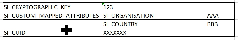

It is second level of properties, I cn see it in query builder:
it is between SI_CUID and SI_DATASOURCE_REFERENCES|Column 1 | Column 2 | Column 3|
|SI_CRYPTOGRAPHIC_KEY | 123 | |
|SI_CUSTOM_MAPPED_ATTRIBUTES | SI_ORGANISATION | AAA|
| | SI_COUNTRY | BBB|
|SI_CUID | XXXXXXX | |
Definition of SI_CUID is in universe Properties.SI_CUID, but the question is how to define the second level in case of attributes. Properties.SI_CUSTOM_MAPPED_ATTRIBUTES.SI_ORGANISATION and SI_CUSTOM_MAPPED_ATTRIBUTES(SI_ORGANISATION) are not good definitions. In general the question is how to define in CMS properties of the properties.
if you have dafinition Properties.SI_CUID the output is XXXXXXX but i need to define function with output AAA (second level of properties).
