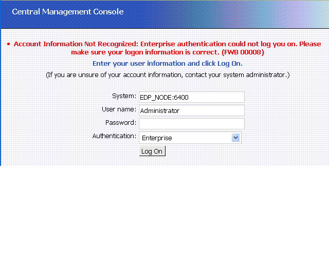

Hi all,
Recently I installed Business Objects Edge Series evaluation version on Windows XP SP2.
When I logon to CMC it is giving an error "Account Information Not Recognised:… " for Administrator account. A Screenshot is as shown in the attachment.
Also I have problem in logon to CMC as administrator. Also I have to login with Authorization as Standalone.
Please provide a solution as early as possible.
Thanking in advance.
Rajesh.

Hi all,
Have anybody a solution for my problem mentioned above?
Or, Is it that I am not able to mentioned the problem clearly?

Nothing complex, just enter your admin account name (Administrator) and passoword that you assigned for your user account during installation - it works. The reason in that you think that you assigned password for User account, but program assigned it for Administrator’s one, as a result it does not work with your User account name, with Administrator only…Dumb shirt, I think they are make their soft so unfriendly for users becouse of very profitable “troubleshooting consultations” for reach “not very smart clients”
