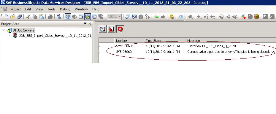

I had an issue this morning when am running one Job having source as excel sheets and loding into Oracle tables and got failed due to:
“Cannot write Pipe ”
I dont know what it means. I have restarted the Job it ran fine…
Does anyone have any idea regarding this? PFA, the screenshot…
I’m in BO 4.0

Do you use a function anywhere in the transformation? I had this issue when running functions with group by condition running in DI.

Are you using the Run as a separate process option in the Dataflow? I’ve seen that cause pipe errors.

No. I’m not using the Run as a separate process option in the Dataflow. I have checked my all data flows properly…

Today saw a similar error…Do you have a Data Transfer Transform or a Bulk-Loader in your DF ?

No Ganesh. I’m not using any of that options… simple dataflow 1:1 mapping only from excel to oracle DB… but lot of dataflows(1500)… only at that time only i got that error now Am not getting…
