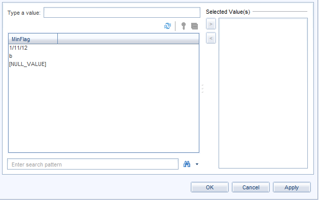

The problem is when I try to filter. Instead of getting a list of dates, I’m getting this (screenshot at the bottom) where there are no lists of dates but a single date along with the “b”. When I pick to be “not in list” the entire report turns blank.

That’s because the Min() function produces a measure object, and in Deski if you use a measure object in a formula or variable the output is automatically another measure. You cannot filter on measures (unless the measure is a universe level object and you use the global filter function).
The only way round this in Deski is to create an object in the universe which replicates the logic of your initial Min() object but qualify the output as a dimension.
Alternatively, move the report to Webi. It’s a bit of a hack, but you can change the output type of a formula to not be a measure provided you don’t include any aggregate functions in the formula.
