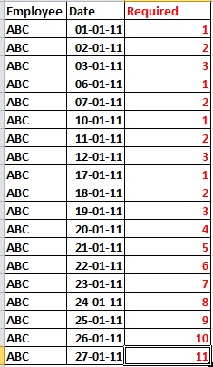

I’ve a peculiar requirement where I need to calculate consecutive working days for employees.
Info I’ve is:
Employee, Calendar Day. Calendar day is only populated when the employee goes to work. If not it is blank.
Based on calendar day … if an employee worked consecutive days, I need to count each day as 1 and sum up to get number of days consecutively worked in a month.
for ex:
Please refer the screenshot attached.
Please kindly help as it is killing me :hb:
Thanks a million in advance.
Ravi Kanth

Hi Andy,
With your formula, I can get only 1 in all the rows. I want to get runningsum but it should become zero when the difference is not 1 day.
For Ex:
01.01.2011 - 1
05.01.2011 - 0
06.01.2011 - 1
07.01.2011 - 2
15.01.2011 - 10
20.01.2011 - 0
21.01.2011 - 1
22.01.2011 - 2
23.01.2011 - 3
31.01.2011 - 11
like this.
Please help me.

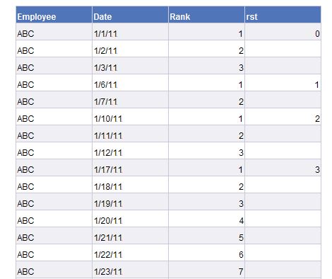

I have a close solution.
Create a variable (referred to as [rst]):
=RunningCount([Date] Where (DaysBetween(Previous([Date]);[Date])>1))
Add this to your block, use it as a break (and remove header and footer, then apply table header).
Next, another variable:
=Rank([Date];Bottom)
Should give following results (attached).
You’ll need to hide the [rst] column using white text on white background, or whatever you’re comfortable with.
HTH
NMG
