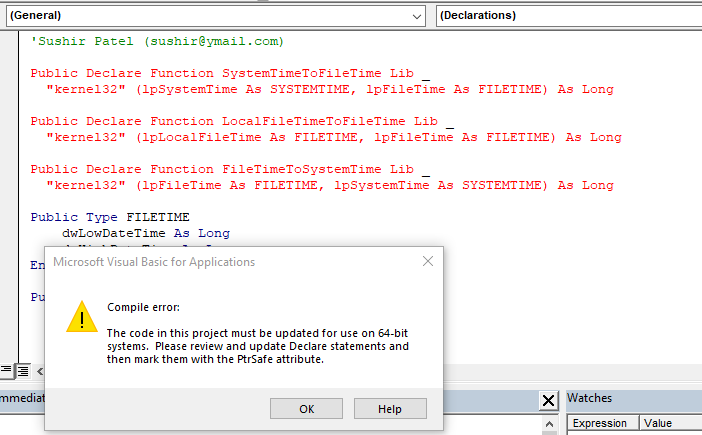

Will this ever be updated to work with SAP Business Objects 4.3?

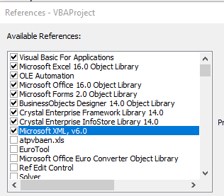

I have upgraded the Ms office to office 365 since then Documentor is not working. Getting the following error.
I also checked the References - VBAProject and found the following checked.
I have SAP BO SP05. It was working well, and all of a sudden has stopped any help highly appreciated.
Hello,
SAP BI COM libraries do not work with 64bit Office/Excel. So you must stick to the 32bit version.
