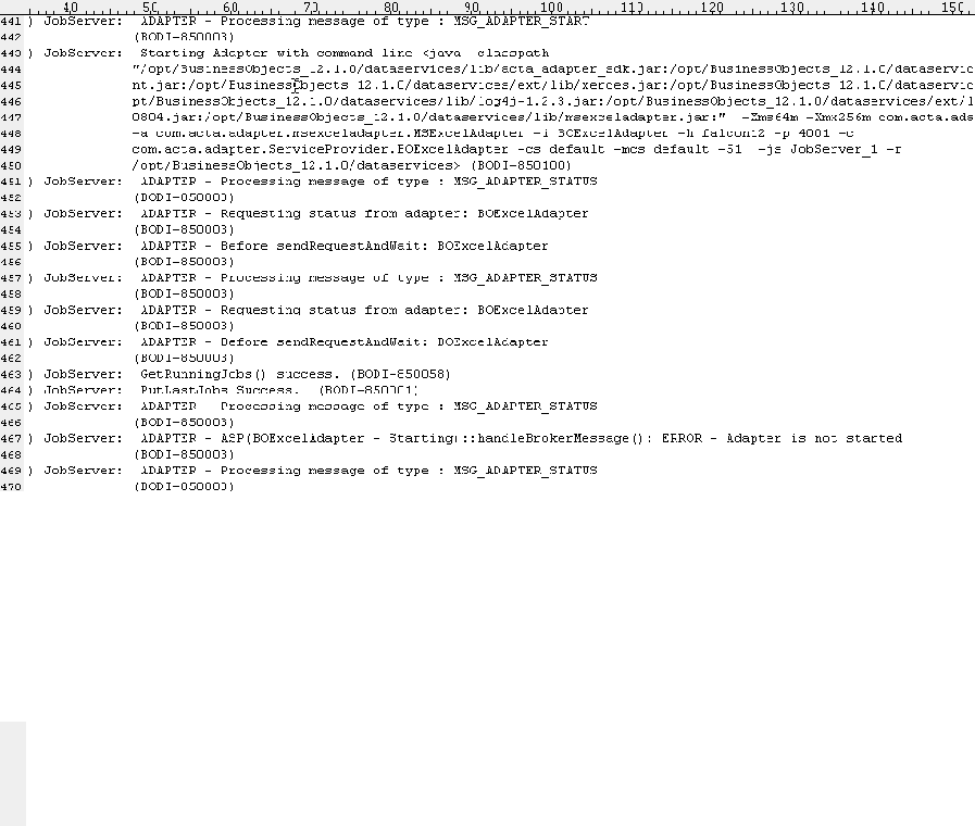

Hi guys,
Thank you for you responce,
I did the same thing as you mentioned in your document.
But when I click Start Adapter (management console)after configuring, this is not getting started.
Attached are the entries from server_eventlog_.log file
I have checked that the .jar files are in correct directory, and they are.
I am not much familiar with java or UNIX, please let me know how to validate, that java is working when the adapter is started.

I have copied the values from log which are used to start the adapter
Starting Adapter with command line :
java -classpath “/opt/BusinessObjects_12.1.0/dataservices/lib/acta_adapter_sdk.jar:/opt/BusinessObjects_12.1.0/dataservices/lib/acta_broker_client.jar:/opt/BusinessObjects_12.1.0/dataservices/ext/lib/xerces.jar:/opt/BusinessObjects_12.1.0/dataservices/lib/acta_tool.jar:/opt/BusinessObjects_12.1.0/dataservices/lib/log4j-1.2.3.jar:/opt/BusinessObjects_12.1.0/dataservices/ext/lib/poi-2.5.1-final-20040804.jar:/opt/BusinessObjects_12.1.0/dataservices/lib/msexceladapter.jar:” -Xms64m -Xmx256m com.acta.adapter.sdk.AdapterMain -a com.acta.adapter.msexceladapter.MSExcelAdapter -i BOExcelAdapter -h falcon12 -p 4001 -ccom.acta.adapter.ServiceProvider.BOExcelAdapter -cs default -mcs default -51 -js JobServer_1 -r/opt/BusinessObjects_12.1.0/dataservices
AdapterSDK version: 12.0.0.0

newdiuser (BOB member since 2008-12-05)
this error is coming because you didn’t give a space after -r option
-r/opt/BusinessObjects_12.1.0/dataservices it should be
-r /opt/BusinessObjects_12.1.0/dataservices
I asked you to run the command from prompt to make sure the process starts, since you are getting this error the process is able to start
