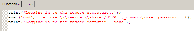

Just for the books, if the jobserver is running with a different account, there is still an option:
https://wiki.sdn.sap.com/wiki/display/BOBJ/Shared+Directory+access

Above command is no mapping-a-drive, it is logging in into the server so you have permission to read from the UNC share.
