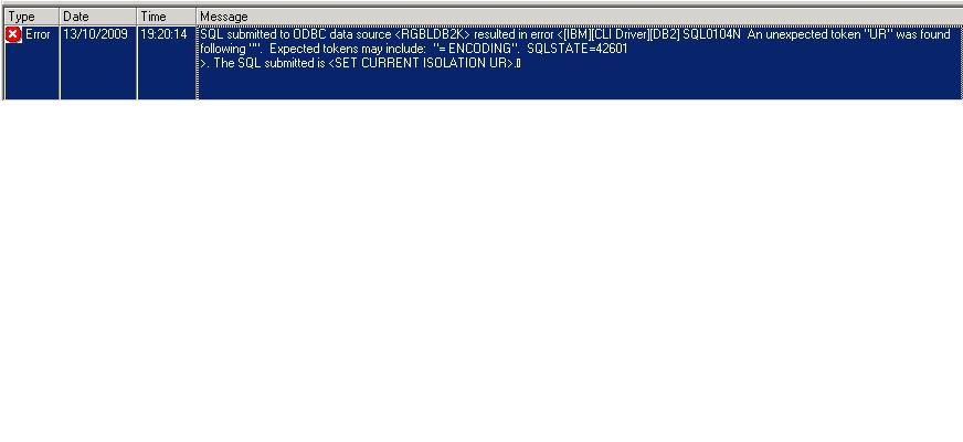

I tried to set Additional Session Parameter and typed following command.
SET CURRENT ISOLATION UR;
It is giving error “An unexpected token ‘UR’ was found ……”
Screen shot of error is attached for your reference.
ritesh.kumar07 (BOB member since 2008-11-05)
when i tried to set addional session perameter as
i was getting error. i replaced UR with READ UNCOMMITTED;
SET CURRENT ISOLATION READ UNCOMMITTED;
In this case following warning is coming instead of error.
Warning:Cannot create stored procedure(s), resulting in non-optimal performance, to improve performance, you must authorize user to CREATE,DROP,and EXECUTE stored procedures.DB2 data source<%1> warning message for operation<%3>;<%4>,SQLState<%5>
I will have to check this, the acutal error is getting suppressed
what happen if you set this from ODBC Administrator (DSN)
remove this from Datastore Session Parameter, and set this in ODBC DSN in the system and see if tables are still getting locked
I set isolation level to READ UNCOMMITED from ODBC Administrator and it is working fine till now.
It is not working from Datastore Session Parameter. I have mentioned error and warning message in my previous reply.
