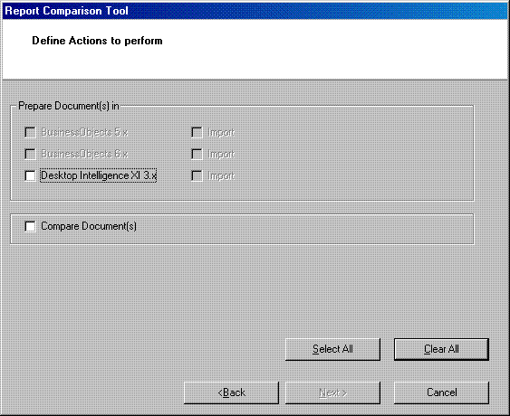

The rct (report comparison tool I know) has the ability to compare version 5, 6, and xi - availability of the options depends on installed versions that rct can find…
see attached pic
Wobi
Wolfgang Bidner (BOB member since 2002-08-30)
