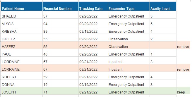

I’m looking to create a variable to remove unnecessary null values from my query results. I will also need that variable to create a crosstab to count the acuity levels by day. Some of the query results return a line with a numeric result and line with a null result. Others will just return one or the other. The caveat is that I need to keep the null results if they are the only result for that patient. I created a max acuity variable which does only display the maximum and keeps the null if that is the only value listed, but I can’t seem to use it correctly in the crosstab.

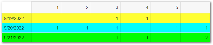

Please see sample data below and a sample cross tab. The cross tab is using the current acuity dimension which includes the additional null values I don’t want. The other fields on the cross tab are variables Tracking Date and # of Patients (see below).
[Tracking Date] =FormatDate([Start Tracking Date & Time];“MM/dd/yyyy”)
[# of Patients] =Count([Financial Number])

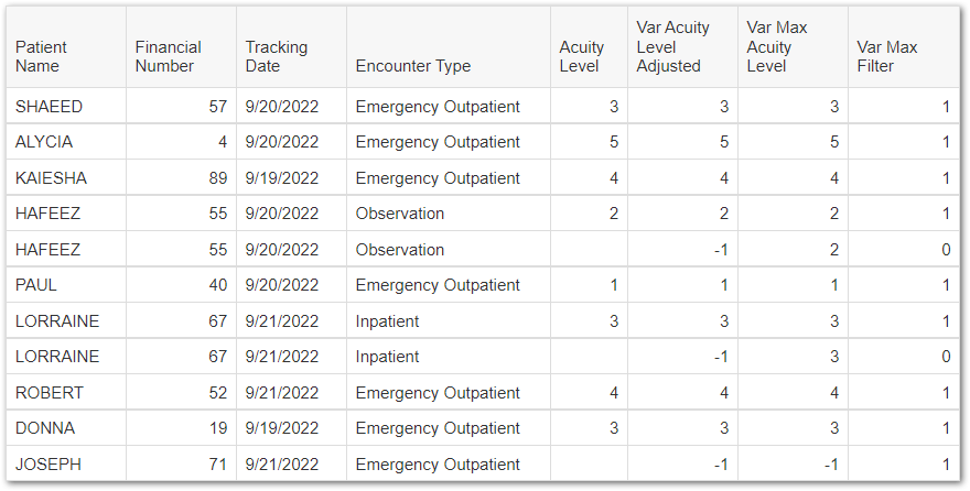

Now if I add those variables it looks like this…
Then we can add a filter to only show the records where Var Max Filter = 1. You can hide the extra columns or even delete them from the table.

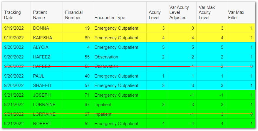

Here is where things break down. When I try to build the crosstab I cannot seem to filter it down to just count the records with the maximum Acuity Level for each patient. Here is what I have color coded to correlate what I understand to be counted where.
Now if I color code the source data…
The two lines I have crossed out are still getting counted. In the crosstab the intersection of 09/20/2022 and Null should be 0 (technically Null) and the intersections of 09/21/2022 and Null should be 1 rather than 2. I do not have any filter applied to the crosstab; Whatever I have tried does not work. @MarkP can you explain your approach further based on what I have shown here so far? Or am I completely on the wrong track?
