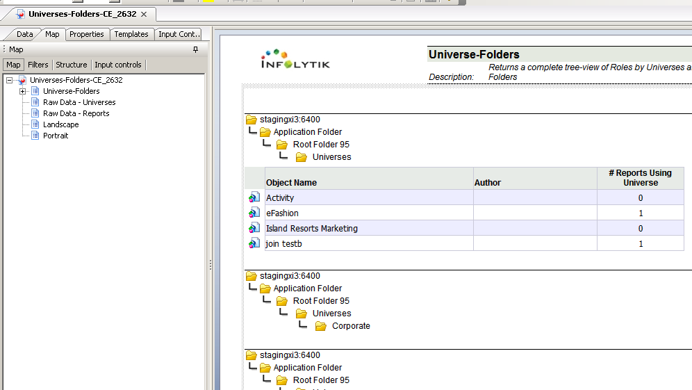

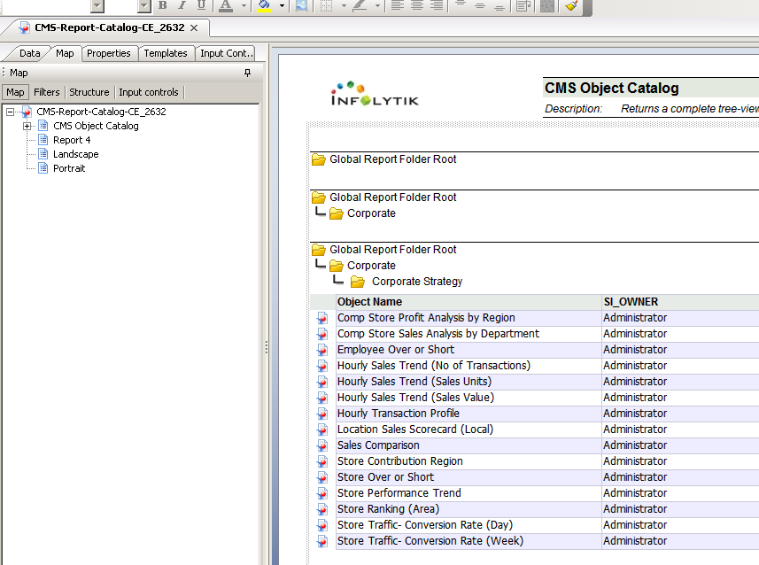

Hi lofty77 -
The most painless way to achieve what you’re after would be to use CMS/Connect Community Edition. It’s - simply put - a data driver to your CMS / enterprise metastore that allows you to report against its contents from within Web Intelligence.
I’ve attached some screens of three new reports that come packaged with the current version (2.6.3.2) that provide Universe-Report-Connection relationships as well as a Reports Inventory screenshot that fully categorizes your CMS reports catalog by Folder.
One of the most interesting features about it is its ability to section all your data across folders hierarchically - the same as you’d natively see it via the CMC - as sections (or PDF bookmarks).
You can download it (yes, it’s free) from my signature.
Enjoy!
