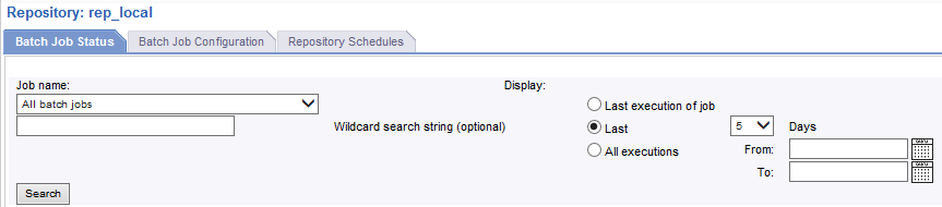

This is not really a problem, but I’m just curious. We recently upgraded to 4.2 SP05 from 4.0 something. Prior to this, the Batch Job Status listing always defaulted to the last execution of all batch jobs. Now that we’ve upgraded, our production console defaults to “Last 5 Days”, although our development console still defaults to “Last execution of job” (and the Days dropdown defaults to 1). I’m curious why this would have changed, and if there is an option somewhere to control this default that I don’t know about.

you can change the default value from the Administrator->Management-> Status Interval page from DS Management Console
Thanks! :+1:
