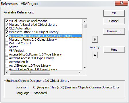

I posted a screen shot of my library references. I used the code as-is and it worked fine. The “LoginAs” was apparently for XI R2 because when I tried to use it with 3.1 it said it was depreciated. When I went back to the LoginDialog it worked fine and started Designer from XI 3.1 which I have installed on my system, along with BI 4.
It works fine. I don’t know for some strange reason I saw two instances of the library fro 12.0. It worked with the second one but not with the first one. Thank you so very much. You saved me and my group lot of time. I truly appreciate your help in this regard.
