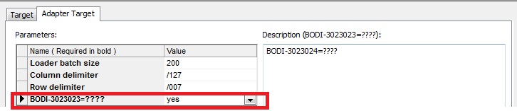

i’ve inserted a SFDC-Table as target…
Since i got the error i searched for the option you mentioned in one of your previous posts…
In the table options i could find an additional (strange) parameter which was default as “No”… (see attached picture)
Is that the parameter which you mentioned?

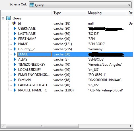

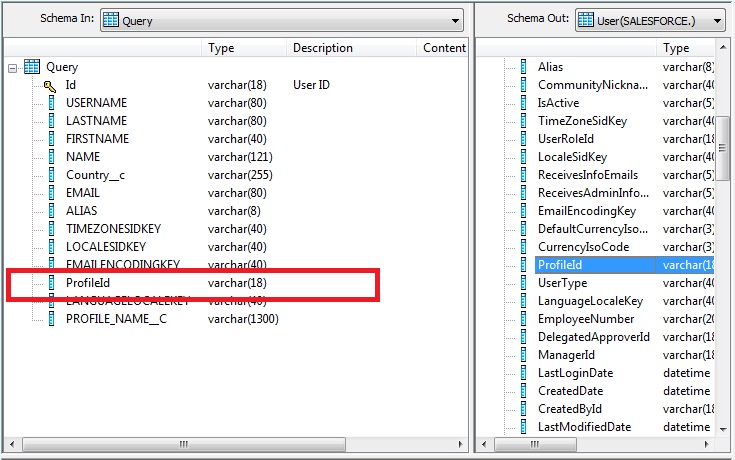

In the Query_Out we have a field “ProfileId” with valid value (see attached screenshot)
If i now try to load data to target table it says…
7032 3452 RUN-058104 12.06.2012 14:06:16 Error loading : <Required fields are missing: [ProfileId]>.
0 0 DBS-070300 12.06.2012 14:06:26 (14.0) 06-12-12 14:06:26 (E) (5264:1940) RUN-058104: |Data flow DF_TEST_SALESFORCE_WRITE|Loader Query_User
7032 3452 DBS-070300 12.06.2012 14:06:26 Error loading : <Required fields are missing: [ProfileId]>.
Now i’m a bit confused… :crazy_face: :crazy_face: :crazy_face:

looking at the snippet of log that you have posted you are on DS 4.0 (14.0), what is the complete version of DS ? you see the strange parameter since the resource file with complete description is missing, if installation is fine then, that’s a bug
The following error is coming from SFDC, you are not setting a valid value for ProfileId, setting it to NULL in mapping in DS will prevent it from going to SFDC (DS will not pass the mapping that are set to NULL to SFDC)

Coming back to the ProfileId:
We’ve set a constant for ProfileId (e.g. ‘00e20000001UdoiAAC’) which is a valid one in Salesforce. (see attached screenshot)
If i execute the job the same error is coming up!

what is the version of DS you are using ? this was fixed in 4.0 SP2 or 3 I don’t remember, drop a new SFDC target table to DF and open the properties of the table, do you see a parameter named include column names ?
if yes, then set that option to yes
in the Query remove the columns that are not mapped run the job, DS SFDC Adapter will only load column that are mapped, make sure you are mapping all the required columns, else the SFDC load will fail with SFDC errors
