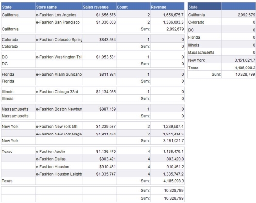

Here’s an example using E-Fashion sales data for 2006.
We can derive a count of Stores in each State using:
=Count([Store name]) In ([State])
…and we can return the Sales Revenue conditionally with:
=If Count([Store name]) In ([State])>1 Then [Sales revenue] Else 0
…which we can then sum. See the attached pic for illustration.

No, even easier:
=If(Count([Store])>1;“Subtotal”)
=If(Count([Store])>1;Sum([Sales]))
Don’t need a calculation context as they are in the context of the State break. 8)
