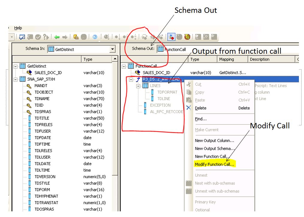

A couple of points.
  1. This function should be called from within a normal DF; not and R3 DF.
  2. It cannot be called using the standard DF column command line. Example: You can call a DS function in a Schema Out column like “WL_GetKeyValue (parm1, …)”. This does not work for the Z_AW_READ_TEXT function (because is is an R3 function).
  3. You must call the function as follows:
    A. Add the function into your R3 data store by importing it under “Functions”.
    B. In DF query; Schema Out; right click on column where you want the output to be and select “New Function Call …”
    C. Complete the function setup by providing the parameters (via columns or variables, etc.)
    D. Click through to OK and the output of the function call will be added to the DF Schema Out columns.
See screen shot attached.
donpowell58 :us: (BOB member since 2006-05-18)

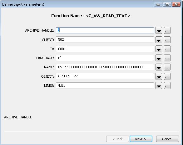

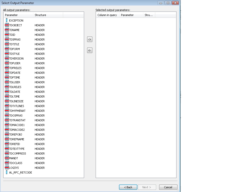

I am trying to call Z_AW_READ_TEXT wrapper that in turns calls out READ_TEXT functional module to get Long Text at line item levels.
Currently, when I am using it has 7 input parameters, I am sure of 6 parameter values’, but last parameter is being called as LINES (Screenshot 1 - Input_Parameters_Z_AW_READ_TEXT), for which I am not sure of what input should be given.
For time being I have provided NULL as input value for this field (LINES), but I am unable to find any line item level fields in the output parameters or Export Parameters (Screenshot 2 - Output_Parameters_Z_AW_READ_TEXT).
So, I am unable to find any line item level output, only headers are coming out.

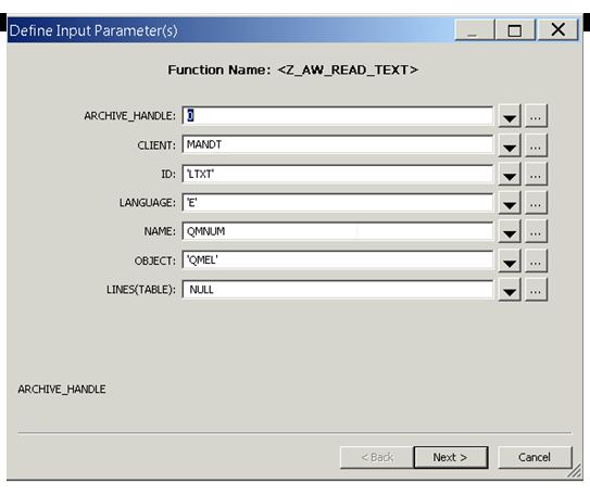

You are correct, Lines should have a NULL value.
I would check the see what fields you are using to pass to the function
i.e. for me to get my text out of SAP I used the following setup see-attachment. It may be that you have an incorrect parameter that is why it cannot find LINES.
Good Luck.
toscajo (BOB member since 2002-09-04)

Thanks for your response. Please find below screenshot for reference that contains input values that I am providing.
I have tested functional module in SAP, that is not providing values at header item level, however provides correct line item level values.
There are 2 issues here:
  1. With the same input that I am providing in SAP, it is giving line item level values
  2. In DS, while calling the functional module it is not providing Line Item level fields at all in output.
Please find below screenshot for reference with the input values that are being provided and also output in SAP. I am hard coding all input parameters.
Ravi
