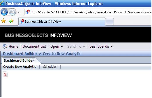

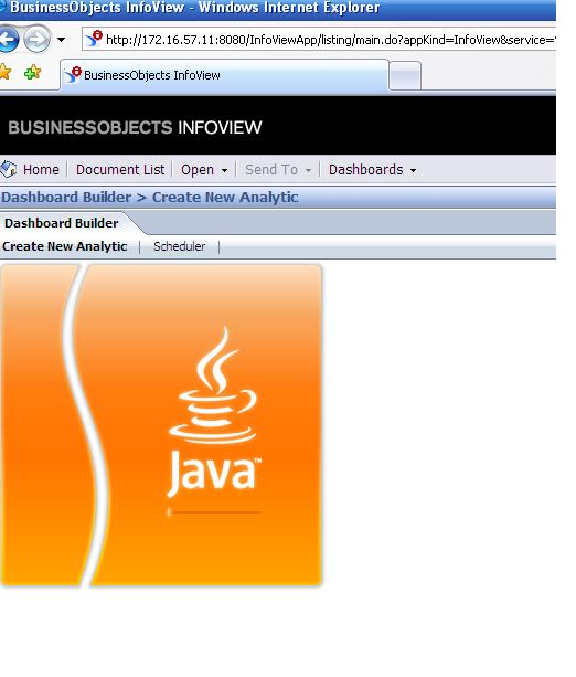

I am using BO XIR3.1, Internet Explorer 7 and Java version 1.5.0_15-b04. When i go into the dashboard builder and select create analytic the the screen gets stuck on the java logo that appears and then i have a red cross in its place.
I cannot edit analytics.
the images are attached.
can anyone help me. its urgent.
kindly guide to any patches that i might need to install for IE7 win xp.
the error i get is :
load: class aa.st.AVApp.class not found.
java.lang.ClassNotFoundException: aa.st.AVApp.class
at sun.applet.AppletClassLoader.findClass(Unknown Source)
at java.lang.ClassLoader.loadClass(Unknown Source)
at sun.applet.AppletClassLoader.loadClass(Unknown Source)
at sun.applet.AppletClassLoader.loadCode(Unknown Source)
at sun.applet.AppletPanel.createApplet(Unknown Source)
at sun.plugin.AppletViewer.createApplet(Unknown Source)
at sun.applet.AppletPanel.runLoader(Unknown Source)
at sun.applet.AppletPanel.run(Unknown Source)
at java.lang.Thread.run(Unknown Source)
