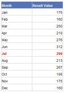

Then create a Alerter that highlights the rows where the flag variable is equal to 1. It will highlight the 3rd consecutive value that is greater than or equal to 250. Here’s my test:

Somehow it is putting a 1 where it shouldn’t. Take a look.
Image Link - Improper Flag
williamdholmes (BOB member since 2011-09-29)
I have no idea why that’s happening. Can you save the document for all users, and send it to me, or attach it here?
