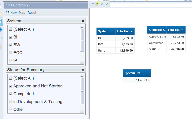

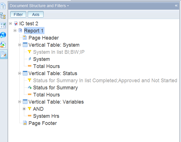

Sorry, I didn’t see that you were asking about screenshots and I have attached.
Note that the screenshots show the blocks after Input Control selection. The Variables block (on bottom) needs to calculate the sum of hours from both blocks above it after input selection. As you can see from the screen shot it is not calculating correctly. It’s actually calculating the sum of hours after applying the filters from both blocks together as opposed to individually. In other words it is filtering the 2 systems selected and then further filtering for the 2 Statuses selected then summing. It should be filtering on the 2 systems selected (for all statuses, not just those selected) and then summing hours for block 1, and then filtering the 2 statuses selected (for all systems, not just those selected) and then summing the hours from block 2 and finally adding these 2 summations together for a grand total. You can see from the 1st screen shot that there are more than 2 statuses and systems returned from the query,
I’ve tried all kinds of calculations methods including NoFilters() and various calculation contexts (ForEach, ForAll, et.c). I just can’t get it to sum correctly.
