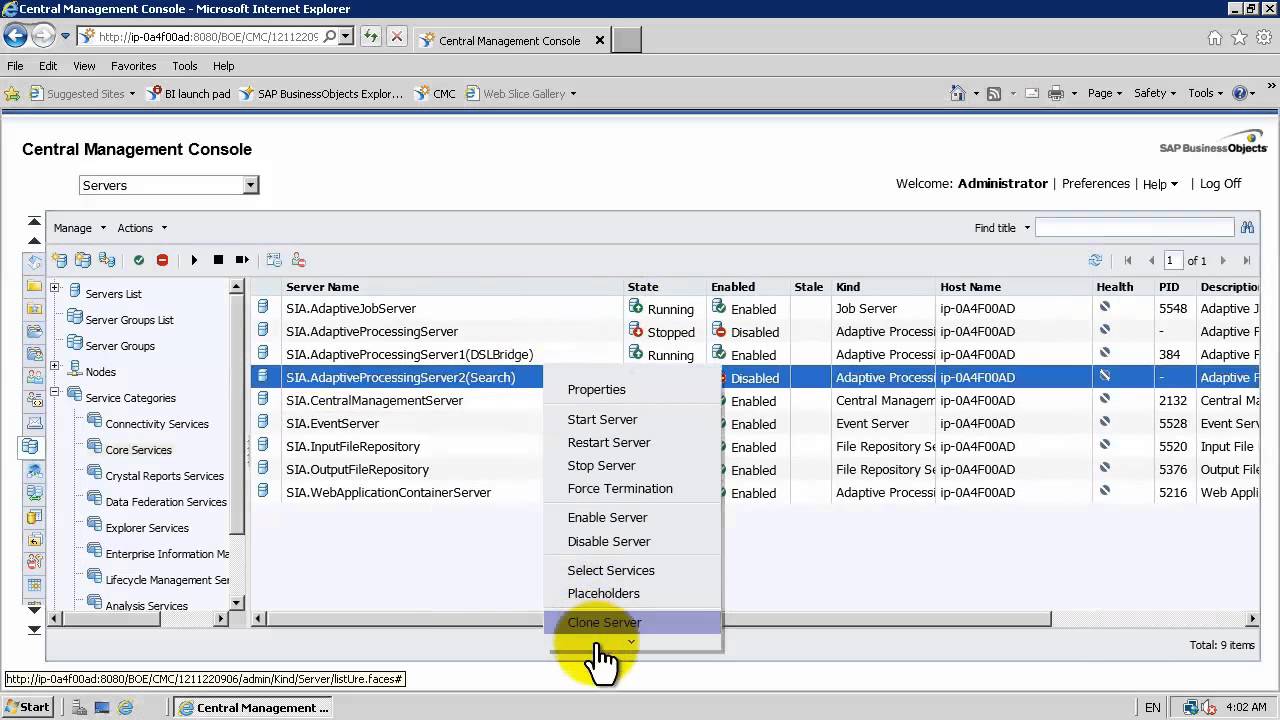

:nopity: Well, I followed a very straight forward video on splitting out Adaptive Processing Servers and did so in the test environment:
Its good and informative. However you will need to go into Monitoring and change the Server rules, the video does not really tell you that.
All the servers I created are at Failed(circle with white stripe) or have a red box. You need to go into Monitoring to change the rules.
To compound the issue I don’t have Adobe Flash, you need this for monitoring to work, in the test environment and need to get infrastructure team to do this.
Its more complicated than I thought :smiley:

Solution:
Split out the PSS i.e. make a clone of the APS with only the PSS on it. Please read this for naming conventions Cloned Adaptive Processing Server (APS) - Monitoring\Metrics
Once the clone is created, Central Management Console (CMC) go to Applications, right click on Platform Search Application, select properties, click on ‘Stop Indexing’.
At the time of writing this I am hoping it resolves the issue.
