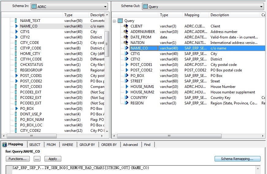

From a mapping. You simply select the column within the query of the abap dataflow and click on functions - there the category of your SAP datastore will show up and all functions you have imported.
ok got it… thanks a lot!

Hi all,
i’ve inserted the function call within the ABAP-Workflow (see picture)
Afterwards i imported the automated generated ABAP code into target system…
If i now execute the job on BO DS, i’m getting an ABAP dump (See attached dump)
Can somebody please support me to fix that issue?
Or does somebody know why this dump is now coming up?

The trick is, that your Import-Parameter for the FM is type “ANY”.
BO DS will import that as a varchar-field.
Then you can handover every value to this ABAP FM without getting a dump and remove the unwanted chars.
In my case this function module is working fine…
