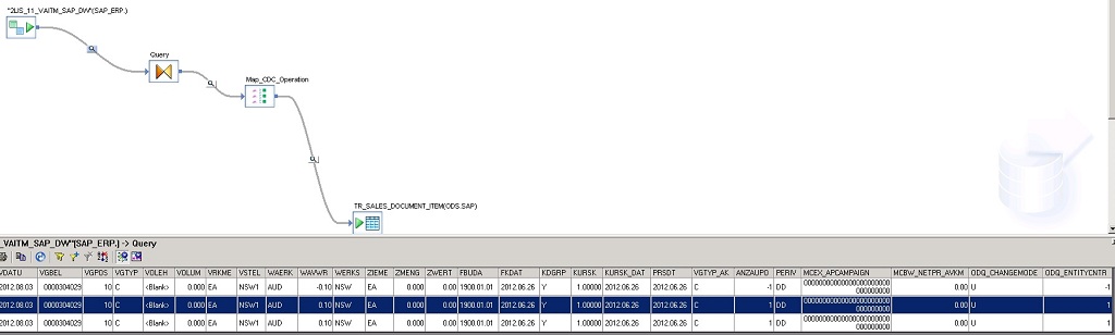

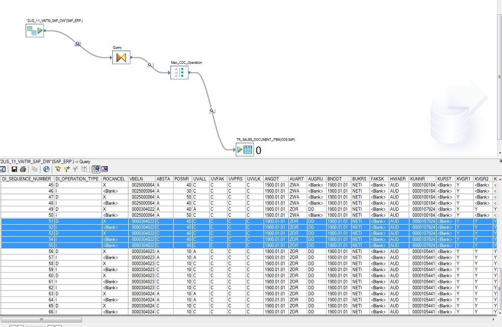

The attached screen shot should show you both the dataflow and the issue.
Note this was obtained in debug mode by clicking the first magnifying glass before it even gets to the query.
Document (VBELN) 0000304022 is a new document. It wasn’t present prior to this delta (we created it for the test case). If you follow the secuence highlighted you will see:
51 - tried to send a delete for a non-existent record (0000304022 , C, 40)
52 - inserts this record
53 - delete this record
54 - inserts this record
55 - inserts again - This caused a primary key violation.
Not when we run the same delta though open-hub, the records come though in a different (and presumably correct) order.

You did all correct from a DS perspective, even the include-in-transaction.
Why do we see two Insert records, I guess that is the important question. Can you show the other 2 to 3 delta related columns returned by the extractor and their values (the last two columns in the extractor and maybe a BW related field).

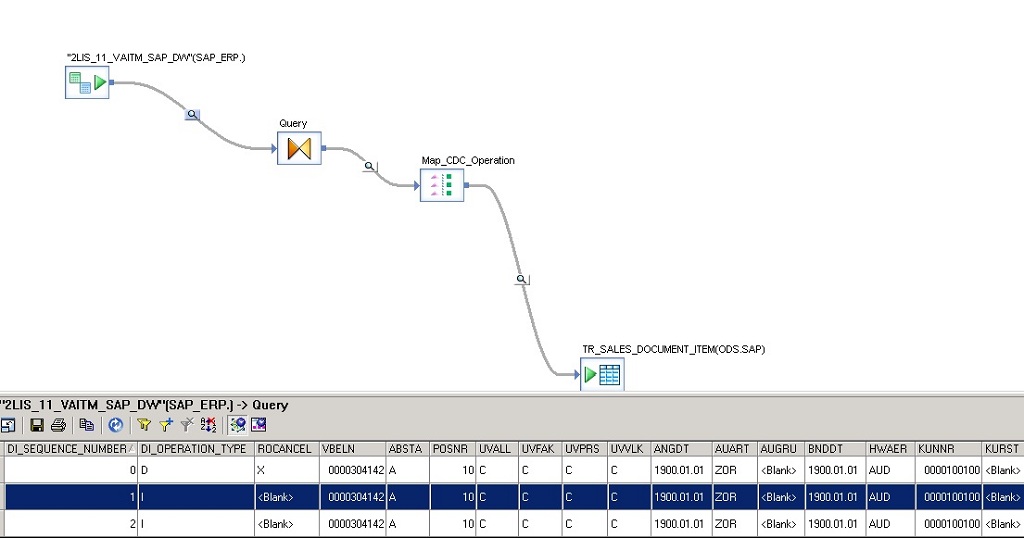

Ok. I’ve reproduced it again and captured screenshots to show you the last few columns as you requested.
