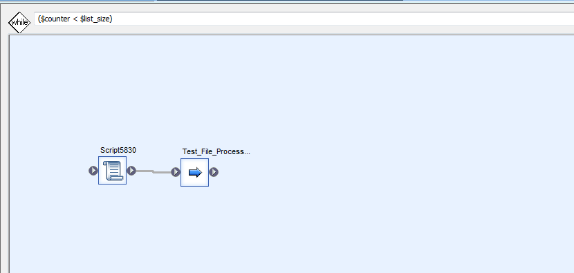

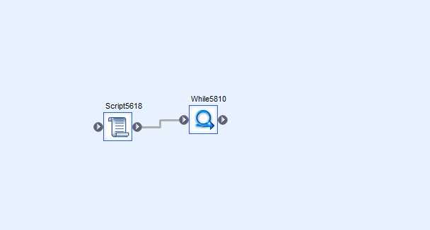

It is still an issue, It is not entering into the loop and says success.
Please advice.
First Script before while loop.
wait_for_file('/test/eFeedsRW/MainFrame/Acknowledge_Files/*.TXT', 1, 1, -1,$file_list, $list_size,',');
print('Number of file found = ' || $list_size);
print('Comma separated file list = ' || $file_list);
$file_list_temp = $file_list;
print('File List Temp = ' || $file_list_temp);
Second script within the loop.
Begin
$counter = $counter + 1;
print('While Loop Counter = ' || $counter );
#print(' comma index = ' || index($file_list , ',', 1));
if($counter = $list_size)
$file_name= $file_list_temp;
else
$file_name = substr($file_list_temp , 1, index($file_list, ',',1)-1);
$file_list_temp = substr($file_list_temp, index($file_list,',',1)+1, length ($file_list_temp)-index($file_list,',',1));
print('Current file in process is ' || $file_name);
print(' Remaining file list is = '|| $file_list_temp);
End
RUC :us: (BOB member since 2010-05-03)
I can’t see the variable ‘$counter’ being set anywhere outside of the loop. Are you initialising it to 1 or 0 in a script?
Nemesis :australia: (BOB member since 2004-06-09)

I think it is not mentioned in the SAP Notes.
Should I need to hardcode the value in the variable ??
Please advice what should be the default value ??
Not a big surprise. I get the impression that the notes are typed by administrators rather than techies.
No, but you probably need to initialise it to avoid it being evaluated as NULL
I’d try ‘0’, but it depends on when you want your loop to complete.
