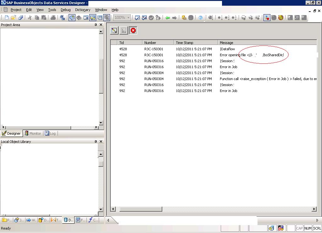

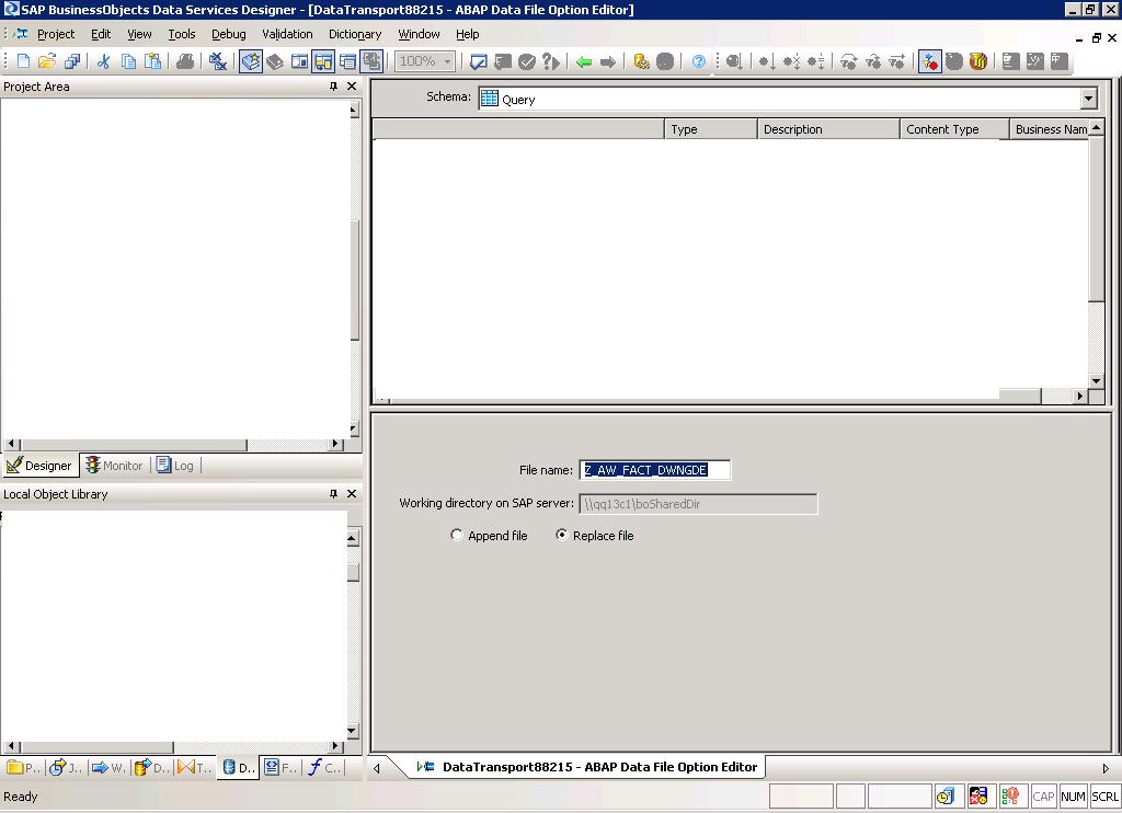

The error is as attached, error in opening file
Does it matter if the SAP server folder and my login account does not have the same rights? I am not sure (need to check as the server not with me at the moment) but I am suspecting the SAP application may have full rights while the login account should have read only.
regards,
Barry
barryn_99 (BOB member since 2009-06-15)

I would like to see proof points. Screenshots. Show me the login-tab of the BO DataServices Service. The hostname of that server where you checked for the service. Proof you are actually using that job server.
And the trace log of above job execution as I am not 100% sure if the ABAP dataflow did complete and it is not related to the jobserver at all.
