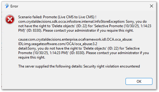

It seems to go fine until promoting All Folders resulting in this error…

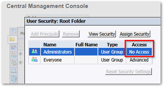

Upon investigation, I find that on my destination system the Administrators group has No Access to the Root Folder (Top-Level Access > All Folders)…

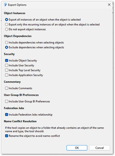

On my first attempt, I selected “Include Object Security” only…

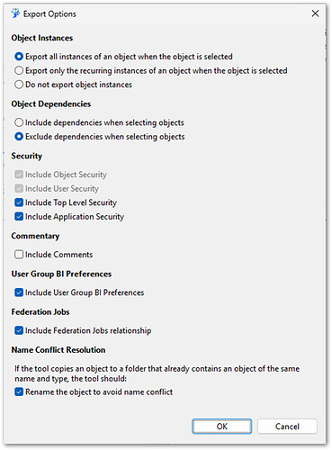

On my second attempt, I selected “Include Top Level Security” and “Include Application Security”…
Both attempts resulted in No Access for the Administrators group.

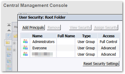

Good questions. The source system has the Administrators group with Full Control…

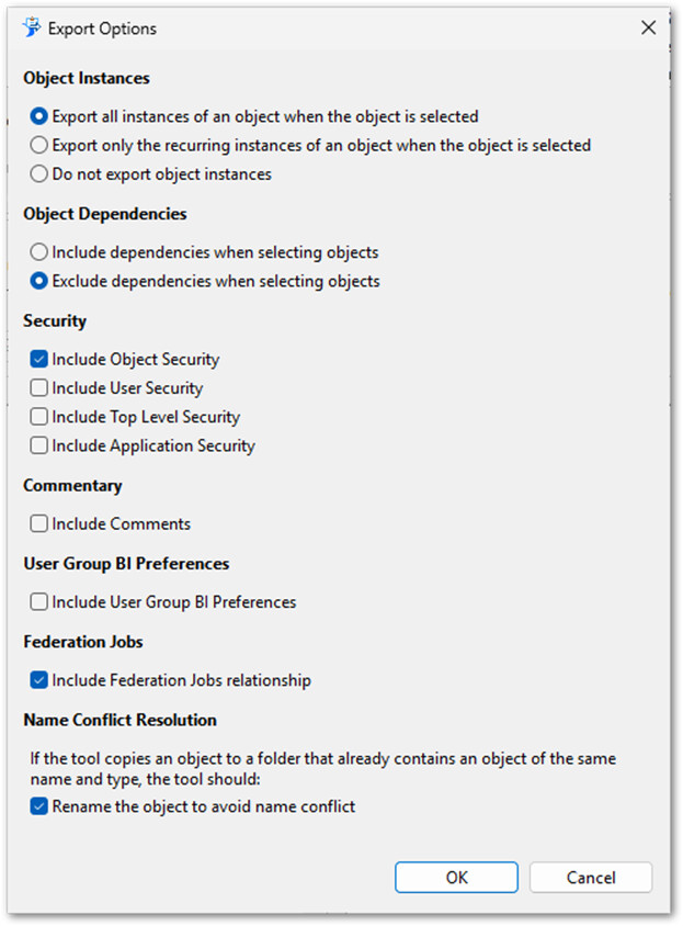

From the KBA I referenced, unchecking all security options is specified. Then you promote just the security later.
That’s worth a try, too. At least you’ll be confident that you can get all your content over, and then you can apply the security manually, if the second migration (of security rights) doesn’t work. Personally, I would use the SDK to synchronize security, since I’ve had bad luck with migrating security in the past (I will likely be doing this early next year).
Leaving all security options unchecked seems to have worked. I got my reports migrated to the new test system. Now to figure out how to apply the security.
