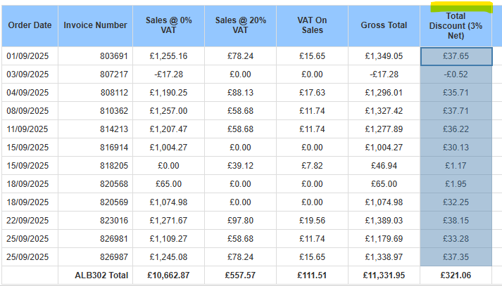

The report has two tabs, one summary without the product code in and a detail tab that includes the product code. The display of the new rebate calculation is working correctly in the detail tab where the product code is included but in the summary tab, it’s giving me some crazy inflated figures. Does anybody have a way of getting the correct figures in the summary tab. I’ve tried context formulas but hasn’t helped, such as foreach and forall on the product code.

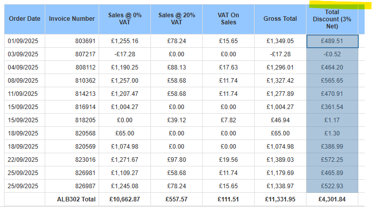

This is the original calcualtion with the numbers you’d expect, so with the clacualtion at everything *3%.
However, when I bring the new calcualtion into the table, the numbers are way higher than they should be? The only difference is one product code should be calculated at 2% instead of 3% so its odd the numbers are so much higher? The new calcualtion brings up the correct numbers in the detail tab.
if the numbers are correct on details-tab, you must insert the product code into your calculation-context,
but pay attention to parentheses for input- and/or output-context !
On the summary tab can you just repeat the details tab report but then suppress the details?
