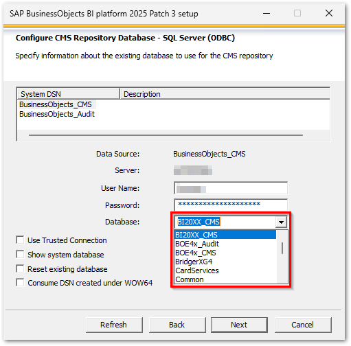

I am attempting to install BI 2025 Patch 3 on a new Window Server 2025 Standard server. I had one of my DBAs create blank CMS and Audit databases on a SQL Server 2019 server. My 64-bit ODBC connections (CMS and Audit) using the Microsoft ODBC Driver 18 for SQL Server test out just fine.
When I try to connect within the install program…
I get this error…

We are using SQL Server, not SQL Anywhere, so that password restriction should not apply, right? I do have two asterisks and a comma in my password. We are using that same password for the BOBJ CMS and Audit databases in our existing 4.3 SP04 Patch 7 system, but that we recently changed and was not used during the install.
Interestingly, it is making a successful connection at some level because it is able to populate the list of databases on that server.
But I get the error above when I hit the Next button.
Do I need to adhere to those SQL Anywhere rules for my SQL Server password? Is there an installation log file some where that will tell me what is actually the problem?
I have tried a very simple password, 7 characters and an exclamation point. Same error.

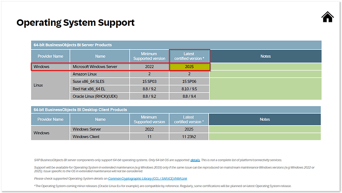

Here is an excerpt from the Product Availability Matrix for BI 2025…
To me that says Window Server 2025 is good to go, right?
If I click on the link toward the bottom of that screenshot…

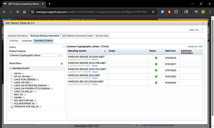

Please check supported Operating System details on Common Cryptographic Library (CCL / SAPJCE) PAM Link
It takes me here. And if I filter on WINDOWS FOR X86_64 I get this…
Which makes no mention of Windows Server 2025. Is that meaningful? I have no idea.

Seems typical SAP documentation. :hb:
They may have updated the PAM for patch 4 but didn’t indicate that it was only available with that patch.
As far as I know, the OS compatibility is always at the SP or major release level, not the patch level (unless specifically noted). So I don’t think it’s intentional that Patch 4 is the first version to support Win25, but rather the issue you had was a bug in Patch 3. I think you’re reading the PAM correctly, that BI 2025 supports Win25.
