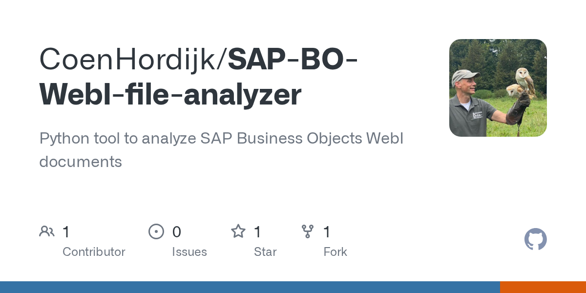

add .zip after the wid file name, open it and enter the rabbit hole :slight_smile:
I created a python script to analyze the contents:
